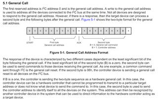

Does this device implement General Call (0x00) for I2C?

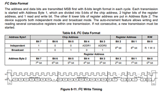

Do you mean the address for broadcast mode?
Actually, you can find all the chip address for LP5860 in datasheet chapter 8.5 just like below figure:
BR, Jared
Hi Jared-san,
No, I didnt mean address for broad cast mode.
I want to know if LP5861T would respond to General call, which is 0x00 adress.
Some device doesnt respond to this General call.
