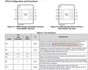

Hello team,
Kindly ask a question: there is an internal pull up resistor in EN pin, can you help clarify the resistance?
Thanks!

Thank you for your question.
This pullup resistor is implemented as a current source instead of a resistor.
However, the value of the current is specified in the EC Table. Please see below:
