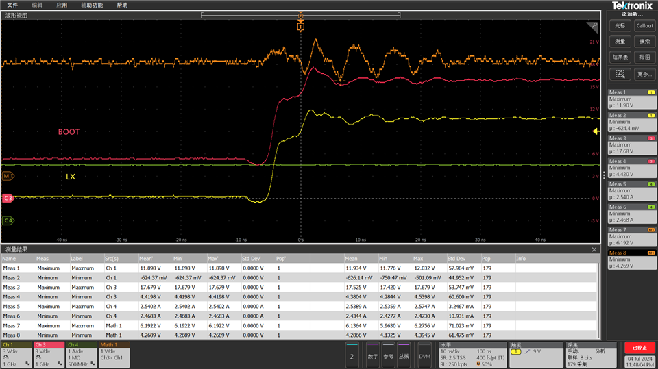

Vin=12V; Vout=5V; Load=2.5A; Cboot=220nF;
yellow wave: voltage on SW pin; red wave: voltage on Cboot's another pin
I wonder why they drop on the rising edge  since there is no current abrupt rise happens, which means the low-side N-MOS keeps shut during the rising edge
