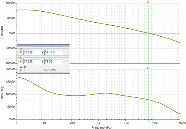

I am unable to replicate the stability plots created in Webench with those created in PSpice for TI.
The Webench design is attached here.

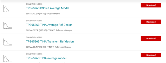

The PSpice for TI design I am simulating with is the "TPS65263 PSpice Average Model" project which reflects the TPS65263EVM-645 eval board.
Inductor parameters, input/output capacitor parameters, and compensation network in the PSpice project was modified to reflect the Webench design.
Input voltage and load currents were also changed in the PSpice project to reflect the Webench design.
Whereas the plots in Webench indicate that design has adequate phase and gain margin for the three outputs, the PSpice for TI design is not stable.
The baseline PSpice design, (reflecting the dev kit), did simulate correctly and was stable before being modified to reflect my Webench design.
The plots look similar between Webench and PSpice characteristically but they're off in value.
