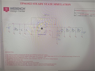

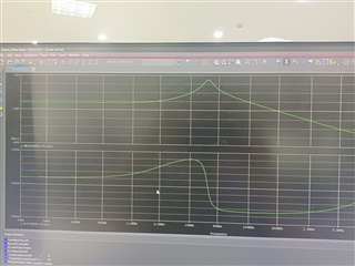

I modify the sch of TPS61022rwu_TRANS as show blow,
but the result of bode plot is not correct, the curve of phase is always blow 0 , and the curve of Gain is always blow 0. the following picture is the result of bode plot.

Hi linjie,
Transient models does not support bode plot simulations. You would need an average PISPICE model for that.
Unfortunately, we could not find an average model for this device.
You could use the Excel calculation tool of TPS61022 or WEBENCH power designer tool below to get the bode plot.

Hi, Sneha
Thank you for your quickly reply. I have find the bode plot by the Excel calculation tool of TPS61022 or WEBENCH power designer tool.
It seams that most of dc/dc ICs don't have average PISPICE model on web of TI.
