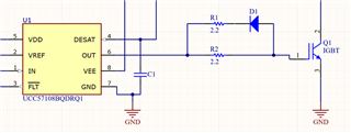

A gate driver with a single output can use a diode in parallel with the gate resistor to adjust the turn-on and turn-off path separately. Figure 3 shows the orientation of the diode D1 for faster turn-off. When the gate driver sources current, the diode blocks the current flow in the path with no resistance. This causes the source current to go through resistor R1 only, making the turn-on gate resistance 2.2Ω. When the gate driver sinks current, the diode permits the current flow and ideally reduces the turn-off gate resistance to 1.1Ω. A resistor can be placed in series with the diode to adjust the turn-off path as needed. For a faster turn-on, simply reverse the diode orientation.
Figure 3: Using a diode for a faster turn-off in a gate driver with single output
