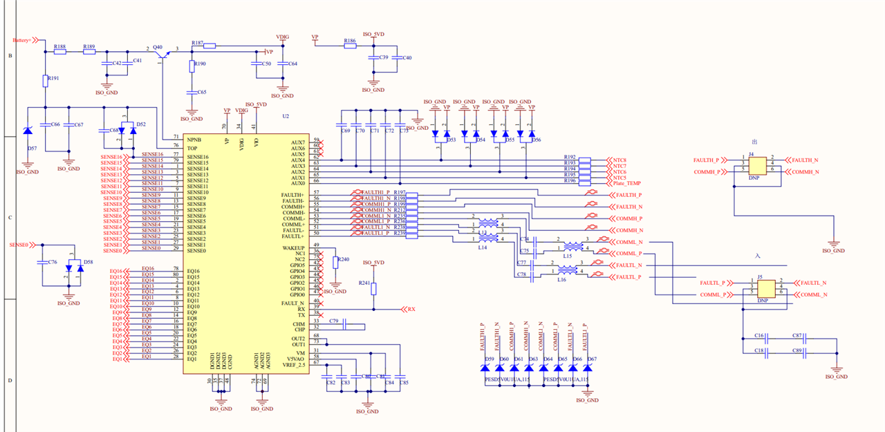

4 cascaded pieces with BQ76PL455A 12S, first one and the last one circuit is bigger than the other two pieces,they are 5.5ma and 7.5ma.
What can i do to improve this?

I presume you are talking about current draw differences between your stack devices. This is likely due to the top and bottom stack devices not having to communicate as much as the middle stack devices as they only have to communicate in one direction. There is no system to correct for this error in this device, unlike our more modern devices.
The only way to do this would be to add additional circuitry to dissipate extra current, which TI neither supports nor recommends.
