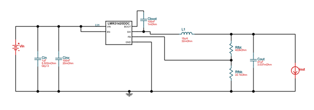

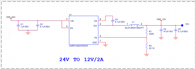

I design circuits using TI Power Design(Power Designer (ti.com)).
Detal: Vin:24V  Vout:12V  Iout:2A
I chose the following design.
The chip(LMR51420) shorted out when it was powered on。Why?
After adjusting the inductance(15uF=>100uF), the chip(LMR51420) works normally.
Is changing the inductance the right way?
Can you tell me the correct way to keep the chip(LMR51420) from short-circuiting?
