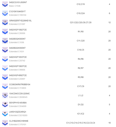

The BOM is given below

    Can you please double confirm about the feedback resistor values present on the board?. Also, if you configure the first output to 5.3V, do you get proper voltage across the output?
    Nitya
  • Hi Nitya,
    We were able to find the error, it was a PCB design issue from our side where the designer had not connected the voltage setting resistors to the output pin on the lower converter.
    A drop of solder fixed it and both converters are working fine at 5.0V, and we will move onto more detailed tests. Thanks a lot for your help!
