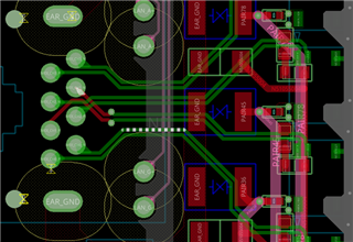

got it, thanks for you data, but we want to you can help us double confirm this schematic whether any problem and if layout can also check, thanks.

Sure, we can help to check the schematic and layout. Should be able to get back to you by the end of next week.

Hi Aaron and Tommy,
Thanks for your patience. Please see the comments below:
1. The typical Ethernet PHY does not need thick wire but considering the PoE is for higher current than data, it is recommended to use a thicker wire at Ethernet port.
2. The primary side FET gate loop is important
3. Though in many cases there is no need to mount the snubber circuit at primary side when you have the RCD clamping, but it is recommended to have a 0805 or larger size snubber resistor.
4. The PSR wire is long, which may influence the Vout regulation accuracy.
