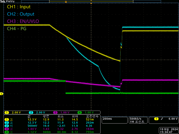

1. Apply 12V to output, and leave input floating.
2. FFT signal is activated due to voltage drop of body diode of HFET.
3. PG pin is reset.
4. Using this PG low signal to control other IC. (EN pin low)
(They added 200~400ohm resistor between input pin and GND to make large voltage drop of body diode of HFET, make 30~60mA current as a result.)

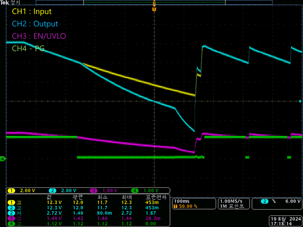

At first they checked that  voltage difference between input and output pin is enough, so PG pin is pulled to low as they expected.
But some time passed, waveform changed a little as below and PG pin is not pulled to low.
They expect that body diode of HFET is broken so the voltage difference is not made to PG pin low.

  • Hello Chase,
    From the waveforms I can see the VOUT is going low. You wrote you are applying 12V at output.
    Can you share the schematic?
    Need to check how EN pin is connected since EN coming up again.
    Device is showing expected behavior from waveforms.
    EN going low making the PG down and again after some time EN pin coming back making PG high.
    Amrit

  • Hello Chase,
    PG is going low because of EN/UVLO going low. Which is causing the circuit to go into protection.
    Please clarify the exact test procedure customer is performing. I can see VOUT is drooping but you said they are applying fixed 12V VOUT.
    Amrit

    First i attach the simplified schematic and block diagram.
    - The device can use one of 2 sources, 12V from PoE or 12V adapter.
    - 12V from PoE is supplied by TPS23754->Active forward converter.
    - 12V adapter is supplied by external adapter. its routing is connected to the output of TPS22811.
    (the input of TPS22811 is connected to 12V PoE from Active forward block.)
    - They want the priority of power to 12V adapter even 12V from PoE is applied.
    - So they thought about the schematic how they can give the priority to 12V adapter, so they thought about the diagram above.
    - the situation of floating input and 12V output is assumed disconnected 12V PoE and applied 12V adapter.
    - And the first waveforms above is about the situation of applying 12V adapter while 12V PoE is applied.
    You can see PG pin is going to low, it is the moment of applying 12V adapter while 12V PoE is applied. And about 400ms time passed, final 12V is switched to 12V adapter successfully.
    But in the second waveform, I could find that PG pin is going low in the monemt of 12V adapter is applied. but PG pin is going to high again and making pulse signal. That is why I suspect about broken HFET.
    And here are my questions again ;
    1. Do you think that it is make sense of the situation above of floating input and 12V applied output?
    2. What do you think about the broken FET? Do you think that it is the reason of not making the waveforms as they expected?
    Please check these issues. Thanks.
