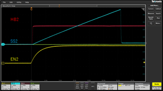

The LM5140 on TMDS64EVM is breaking down.
VDDA and SS2 are working, but no pulse is being output from channel 2 side.
I am turning the power on and off as per the procedures in the user's guide, and am not performing hot plugging.
Despite this, failures are occurring frequently, so I am investigating the cause.

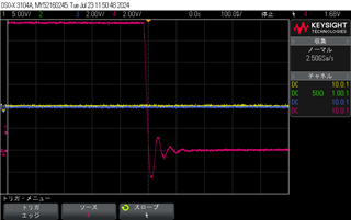

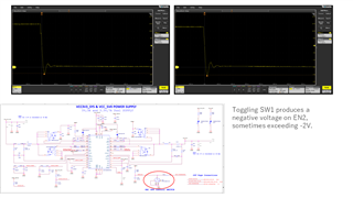

When SW1 is turned off, a negative voltage is applied to the EN2 terminal, and I suspect that this may be the cause of the failure. What do you think?
