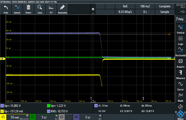

TLV760: TLV76015 Damage issue
Part Number: TLV760

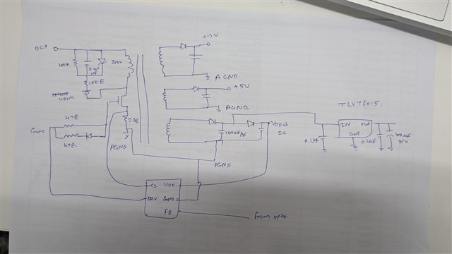

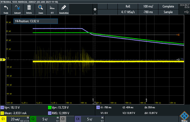

Hello i have connected this regulator at the output of my flyback converter. Im facing an issue where as soon as i connect bare minimum load across the output of the regulator the 15 volt output drops to some 2 volt value. and once the load is removed the Regulator is maintaining the 15 Volt output.
