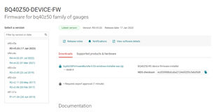

    If possible, can you please try using the latest firmware version of the bq40z50 and see if the issue persists? The latest firmware version can be found below:
    https://www.ti.com/tool/BQ40Z50-DEVICE-FW
    Anthony

    When I read a 1.6 version - does that mean I have a bq40z50-R1 version of FW? What version will I read if the battery pack was updated to the latest FW? I only saw a 2.08 in the R2 release notes, nothing afterwards. Do they update to a version 3.x for R3 FW and then 4.x for the R4 FW? I didn't at first realize that the latest BQ40Z50  firmware is a firmware-only release that can be flashed onto ANY existing BQ40Z50 hardware and may have updates/fixes to the SMBUS that may resolve my issue? I originally thought an R4 FW was only for an R4 device.
    Yes, that means the bq40z50-R1 firmware is currently on the device. If the most recent version of the firmware is programmed to the device, then the version number should be V5.03. Sorry for the confusion regarding this, I will reach out to our team to make this more apparent.
