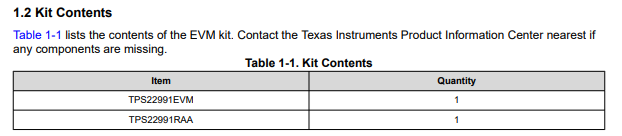

I have a question about TPS22991EVM.
Which is put in TPS22991EVM? TPS22991B or TPS22991C?
In the user's guide, TPS22991RAA is written as below.

Hi Tamazaki-san,
C variant is yet to RTM so it should be B variant on the EVM. To ensure smooth testing, you can also order some spare devices and replace the EVM device with the latest device (if soldering facility is available).

Arush-san,
Thank you for your support. I understood.
