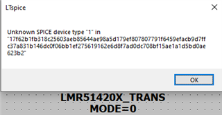

I'm trying to import the pspice model of LMR51420 into ltspice but I'm facing an error with spice device type.
It seems like the available pspice model is encrypted! Is it possible to provide unencrypted model?

We are unable to share this unencrypted model without an active NDA with TI.
In addition, TI does not guarantee that TI PSPICE models work with LTSPICE.

Can you please guide me through the process of NDA? The model is critical for us to proceed with further analysis....
We are not able to handle NDA requests through E2E. Please reach out to your local TI representative to work through this process. You might be able to find your point of contact through the support website: https://www.ti.com/info/customer-support.html
