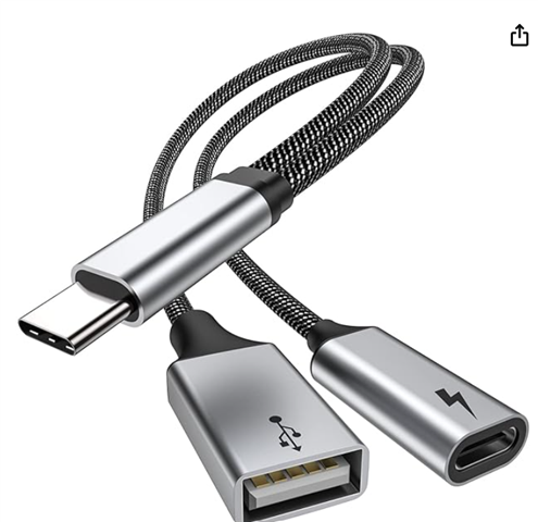

    Thank you for your response. In our system, we don't have a dedicated battery. we use a smartphone with a type C port. The smartphone connects to a USB device via the type C port, and the USB device draws power from the smartphone through OTG. The issue we're facing is with charging the smartphone. We need to be able to use our USB device while simultaneously charging the smartphone, without disconnecting the USB device. I've attached an image of the cable for your reference.
    Thanks and Regards
    Karthik P R
  • Hi Karthik,
    Thank you for the details. After reviewing this application further, our devices were not designed with these types of applications in mind, and I'm not sure a PD controller would be the right device for this type of use case. The TPS65994 and TPS65988DK should only be used when following a PC/NB, TBT, or USB4 reference design.
    I'm sorry I could not help you further. If you'd like to return your EVM, let me know and we can help make that happen.
