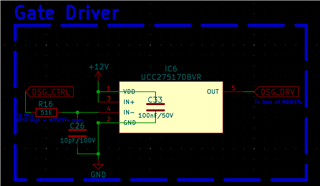

UCC27517: Schematic and functional verification.
Part Number: UCC27517
I am using UCC27517DBVR in a low side configuration to drive 6 NMOSFETs (AOTL66912) used as a switch for a Battery Protection board. Requesting the team to verify if the schematic is okay. DSG_CTRL is connected a MCU GPIO and the idea is that if the GPIO is driven high (to 3.3V), the MOSFETs open and the path breaks. Please also verify if the IC will be able to drive all the 6 MOSFETs comfortably. If the full schematic is required, I can share via private message.
