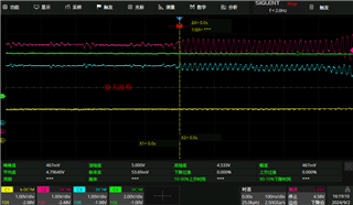

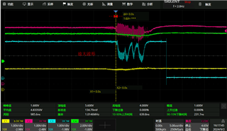

Now, our end customer feedback to us the blow:
1.8A sinking and rsmrst dropping, high-frequency interference was measured in the output of pin56/LDO5 (supplying drv power to pin8/buck2+drv power to pin38/buck1&6).
Disconnecting LDO5 and directly connecting it to 5v of pin57 can also measure high-frequency interference,
From the perspective of action time, the abnormality of "drv power supply" is earlier than standby power such as 1.8A, 1.24A, VNN, etc,

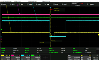

May I ask, besides standby electricity, what else can cause abnormal RSMRST?
  • Hi Zhang,
    RSMRSTB is only set to go low when any of the signals for the checked columns go low.
    Are they able to capture these signals too ? (VSYS, PMICEN, THERMTRIPB, VNN, V1P24A)
