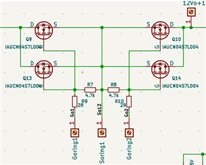

Hi team,
Regarding the LM74930-Q1 in the ORing circuit, we usually put a discharge resistor (R7, R8) between the gate and source of the mos, as shown in the figure below. But the LM74930 recommended application circuit does not have it, so I want to confirm, if the discharge resistor is put, what effect will it have on the gate drive?
Best regards!
Ethan
  • Hi Ethan,
    A discharge resistor is not required.
    When the FETs are turned off, they are connected internally to source pins (DGATE to A and HGATE to OUT). 4.7k is a very high value as it will lead to constant sink of around 2.5mA (VGS = 12V) which is very high and constantly load charge pump.
    Even when the device is off, we have a passive pulldown which keeps the FETs off.
