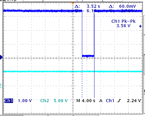

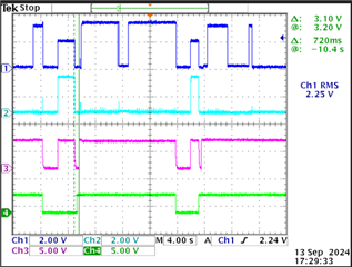

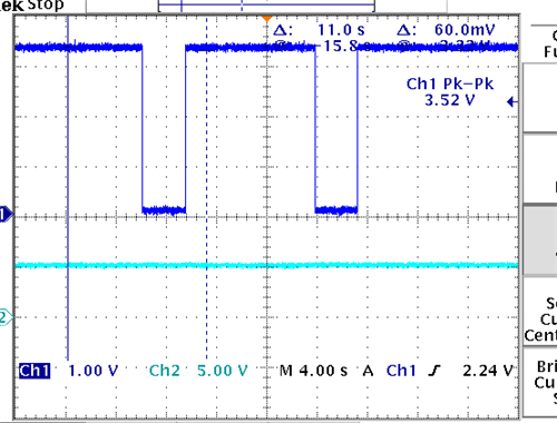

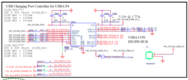

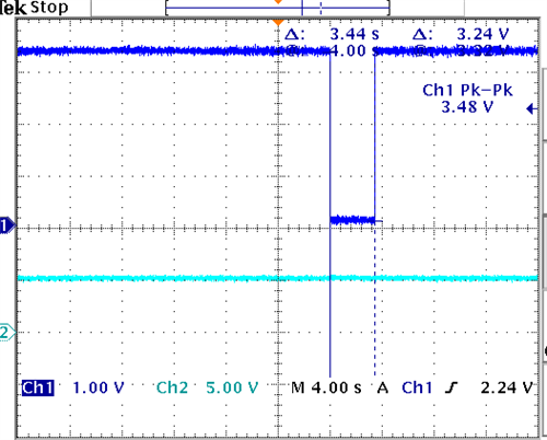

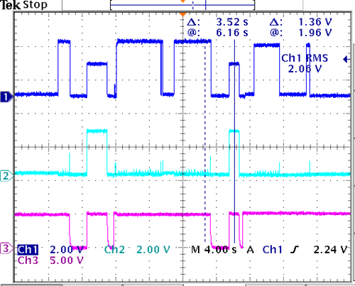

We found TPS2546 when CTRL1 toggle, it may cause device only chaging in 500mA current.
Need re-plug in usb cable to let TPS2546 renegotiate to set to DCP 1.5A charging.
Please see below link test method, schematic and waveform. We want clarify is the behavior is normal?
https://drive.google.com/file/d/19p51cF_-gZ2JG-5Dw1CCBN1IixB3Px5f/view?usp=sharing
Restart CH1=CTRL1 CH2=VIN(we will update to Vout waveform later)
S4 CH1=CTRL1 CH2=VIN(we will update to Vout waveform later)
S5 CH1=CTRL1 CH2=VIN(we will update to Vout waveform later)
