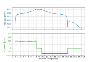

We followed the manual to measure for ChemID and the results were as follows.
It seems to me that this is due to the voltage drop at RelaxTime after the discharge is completed.
If there is no problem with the measurement, can I program this ChemID and proceed to the next step?
Attached is an image of the data sheet for the battery used.
LPHD5026053 800mAh 5C.pdf

Chemistry ID selection tool, rev=2.54
Configuration used in present fit:
ProcessingType = 2
NumCellSeries = 1
ElapsedTimeColumn = 0
VoltageColumn = 1
CurrentColumn = 2
TemperatureColumn = 3
Best chemical ID : 141 Best chemical ID max. deviation, % : 8.36
Summary of all IDs with max. DOD deviation below 3%
Chem ID max DOD error, % Max R deviation, ratio
0 0 0
Warning: Deviation is above recommended level. New chem ID needs to be released for this cell. Please contact your TI representative to send the cell to Dallas for characterization
Selection of best generic ID for ROM based devices like bq274xx
Device / Family #1
Generic Chem ID Device/ Voltage/ Chemistry max DOD error, %
128 bq27421-G1A: 4.2V LiCoO2 13.26
312 bq27421-G1B: 4.3V LiCoO2 14.65
3142 bq27421-G1D: 4.4V LiCoO2 15.4
354 bq27411-G1C: 4.35V LiCoO2 15.54
Best generic ID 128
Warning: Deviation for best generic ID is above recommended level for this device / family. Consider using another device, flash based gauge or RAM programming of custom ID.
Device / Family #2
1210 bq27621: (ALT_CHEM1) 4.3V LiCoO2 13.3
1202 bq27621: (default) 4.2V LiCoO2 14.67
354 bq27621: (ALT_CHEM2) 4.35V LiCoO2 15.54
Best generic ID 1210
Device / Family #3
3230 bq27426: (default) 4.35V LiCoO2 14.24
1202 bq27426: (ALT_CHEM1) 4.2V LiCoO2 14.67
3142 bq27426: (ALT-CHEM2) 4.4V LiCoO2 15.4
Best generic ID 3230
____________________________________________
