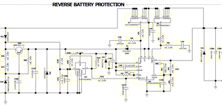

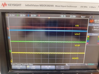

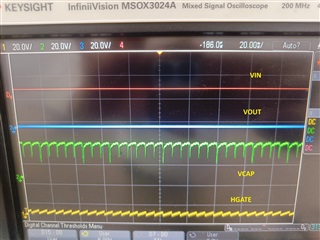

We are using LM74801QDRRRQ1 for reverse battery protection at input voltage of 24VDC and using it for 200V load dump protection. The output 24VDC is fed to six different High Side Drivers. The control signal for these drivers is coming from MCU. We notice that it's able to drive only 5 drivers. As soon as we try to drive sixth driver, 24V output becomes low. HGATE becomes low and hence the IC is not able to provide 24V output when the sixth driver is also connected. We are using IAUC120N06S5N017 MOSFETs at HGATE and DGATE.
Noticeable Points
1. What might be the reason that HGATE becomes low when the sixth driver is connected?
2. The system behaves as expected during steady state i.e. once it becomes ON, it remains ON.
3. When the system is switched ON/OFF, then only we encounter this issue. What can be the reason for this behavior?
