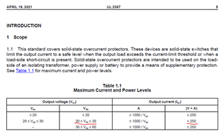

I have a design that is using the TPS26630 E-Fuse and is powered by a power supply whose output is rated above 250VA.
According to UL 2367, this E-Fuse is only supposed to be powered by a power supply whose output is less than 250VA (refer to the picture below).
Is this the device limitation? If not, how do I pass UL since my power supply output is greater than 250VA.
My application has a max voltage input of 30VDC.
