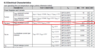

On the main page for the device it is stated that the shutdown current is 0.0001uA, but the data sheet states typ. 0.1uA max. 0.5uA.
Can you pls. clarify which is correct?
Hi Thomas,
The datasheet value is correct value.
