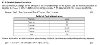

TPS1HC30-Q1: RSNS calculate
Part Number: TPS1HC30-Q1
I have some doubts about the RSNS calculation. I referred to the example in the datasheet, but I'm a bit confused about two points.
  1. KSNS=1814, but the previous specification says 1560.
  2. The calculation in the example (5 V – 1 V) × 1814 / 6 A ≤ ≅1 kΩ is also not satisfied. Are the above two points written incorrectly?
Given my requirements, how should I design RSNS? VDIAG_EN=3.3V ; ILOAD,max=2A ; ILOAD,min =20 mA ; VADC,min=5 mV
