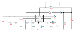

Im using the LM3481MMNOPB as a boost converter for 5 to 12 V (up to 6A). I selected this part and made a circuit according to the WEBENCH recommendations (I changed only a few components, such as the MOSFET and the schottky diode for THT variants for easier cooling).
It works, but when I increase the load above 5A (or if I suddenly turn on a load above 3,5A), strange behaviour occurs:
- the output voltage drops to 6,5V
- audible beeping (at changing frequencies: 6A - 11,886 kHz, 7A - 13,910 kHz and 6,972 kHz, 8A and 9A - 13,114 kHz, 10A - 14,643 kHz, ...)
- the DR pin (MOSFET gate) is not switching as expected - on for 3 cycles, then off for several ones.
I have to go then all the way down with the load to less than 1A to stop this and get back to normal behaviour.
Im scratching my head around this for a few days already. Initially I thought it has to do with the compensation circuit, so I tried different values for the Rsense, Rfilt and Cfilt components (both smaller and bigger than recommended), but without success. I want to try now different MOSFETs with smaller gate capacitance, but I don't know if  the issue could come from there.
I also attach here my KiCAD circuit and a few screenshots from an osciloscope

  • Hi Niklas,
    thank you for checking!
    I try reattachijng the schematics:
    WEBENCH
    my implementation
    Sure, I filled in the excel sheet (everything I could), here are the screenshots from it:
    I hope all images load correctly now
    Best regards
    Tobias
  • Hi Tobias,
    Thanks for the attachments. They load correctly now.
    The first check I recommend is the stability.
    If the system gets unstable at higher loads, it would explain the Vout drop and abnormal switching behavior.
    The bode plot of the calculators show a rather aggressive compensation.
    It recommends maximum crossover frequency of 2kHz to avoid RHPZ instability. This calculations shows 4kHz crossover frequency.
    We also recommend 60degree or more for phase margin for a very stable system.
    Could you check if the ESR value of C8 and C9 really is 5mOhm? This value has a strong effect on the compensation.
    If it is correct, I would recommend to try replacing R4 with a 1kOhm resistor and check if the slower compensation improves the behavior?
    Please also check if this saturation current of the inductor can withstand the expected peak currents of 20A.
    Sense resistance of 3mOhm is rather small (current limit at >50A). I would recommend to use 5 or 6mOhm for R9 to reduce the margin.
    There is no gate resistor at the FET. We normally recommend measuring the SW signal and add gate resistance or snubbers in case there are strong overshoots or oscillation. I am not sure if this is also the case for this design. Either way, you can consider adding footprints for these in the next revision.
    70W in an asynchronous design is generally rather large and the losses on the forward diode will decrease the overall efficiency. If the design works with the cooling in place, this application is fine. For similar designs, I it worth considering a synchronous Boost design instead to reduce diode losses. A suitable part for this would be LM5122 or LM5123.
    Niklas
