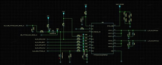

    The 1kOhm will shift the I2T trip values- but shouldn't affect the KSNS ratio.  Could you share the schematic again? The ground end of the SNS resistor, is it connected to the IC ground of the 2HCS10 or is there a resistor/ground network?
    Tim
  • Hi Tim,
    See below the schematic from customer.
    I don't see the problem of GND.
    Thanks!
    Ethan Wen
  • Ethan,
    Got it- no issue with the ground network.

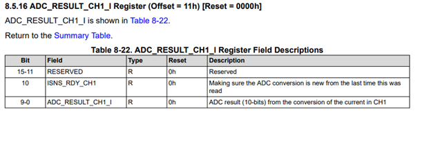

    Just to make sure:
    You are masking out the RDY bit, correct?
    I put 1.5 ohm on the output with 12V supply and I am getting decimal 357. That would translate to:
    (357 * 2.8 * 5000) / (1023 * 698) = 6.999A... which tracks well with the load current.
    Could you confirm the SNS resistor and if they are masking out the actual raw value?
    Tim
  • Hi Tim,
    Thanks!
    I am not quite understand about masking out the RDY bit. You want to make sure that ADC read value should be refreshed correctly?  When ISNS ADC data new conversion is done, ISNS_RDY_CH1 will toggle to 1?
    Ethan Wen
  • That's correct- but I am just making sure that you are not actually calculating the ADC value with the ready bit in the raw value.
