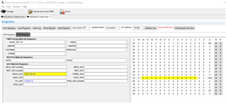

  • Hi Fabiano,
    Thank you for your response. Please see my comments below.
    1) & 2) The manner to read from ADC output registers is expected to be the same between REG0x30, REG0x2C, REG0x2A, etc. Please be aware the number of reserved bits is not consistent between VBUS, IBAT, and VBAT registers. Maybe that is related to your observation of correct VBAT value while VBUS and IBAT do not match expectation.
    Can you please help to share the raw 16 bit binary values for VBUS output (REG0x2C) and IBAT output (REG0x2A), as well as, the hardware measured values you are comparing against for VBUS and IBAT?
    Additionally, if you are not using already I would like to share we have a GUI tool in BQSTUDIO which is useful during software development (can be downloaded from TI.com, link here: https://www.ti.com/tool/BQSTUDIO). The GUI performs the conversions for all ADC outputs, so you can use it to check if your code implementation matches. As an example the below image shows VBUS_ADC output in binary and voltage value.
    3) I can confirm hex value 0x180 for 16 bit REG0x02 (i.e. REG03 = 0x01 and REG02 = 0x80) is correct to set ICHG = 480mA. Please be aware ICHG sets the fast charge current value, but IINDPM set in REG0x06, is the appropriate value for setting the input current limit for the buck converter.
    Still, we are unsure if any additional configuration is required for these specific registers.
    The BQ25622E is able to function and charge a battery with default register configuration. Therefore, in general no additional configuration is required. Specifications related to proper charging of your specific battery or system level requirements may dictate needing to make additional register configurations.
    4)To obtain valid readings from VBUS and IBAT registers you simply need to enable ADC by setting ADC_EN = 1 (REG0x26[7] = 1). You also need to make sure you have not disabled these channels in REG0x27 (All ADC channels are enabled by default). You may not initially see valid readings if you attempt to read too quickly. I recommend implementing at least approx. 50msec of delay between enabling ADC and attempting to read to ensure ADC conversion has completed.
    Garrett
