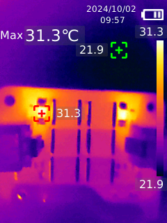

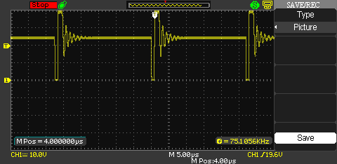

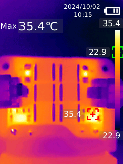

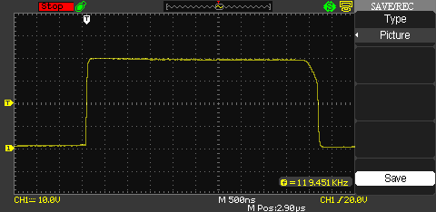

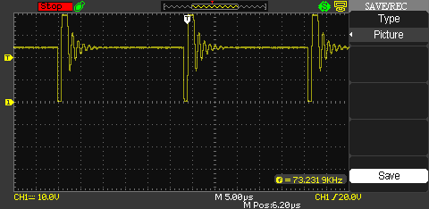

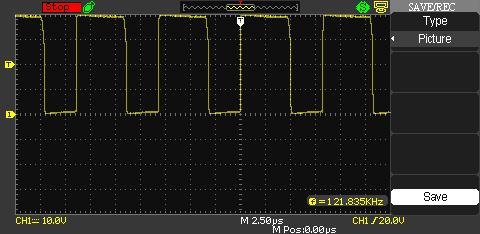

  • Alright, I did the following in order:
    1-) I removed the 220pF snubber capacitor that I had added last from the board. This way, the primary-side snubber circuit was eliminated.
    2-) I removed the 18V TVS diodes on the secondary side and replaced them with 1206 2K resistors in their footprints.
    3-) I removed the 0603 10K resistors on the secondary side and replaced them with small, fragile SOD 323 16V 0.2W Zener diodes that I had on hand and fit the footprint.
    I applied 24V DC and obtained +15.19V and -15.19V outputs with an input current of 11-12mA, which I think is great. Of course, wasting 0.22W of power isn't ideal :)
    Then I prepared a load that would consume a total of 9.8W. I applied 24V DC and obtained +15.17V and -15.18V outputs with an input current of 528-540mA.

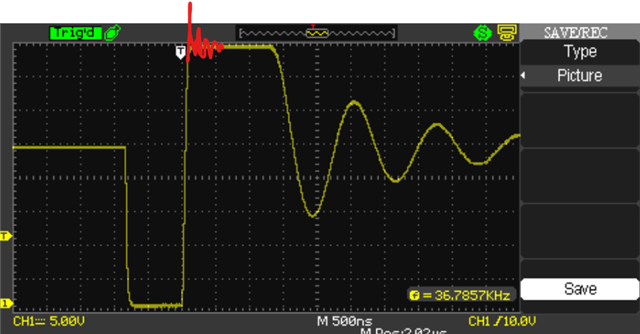

    As for the SW visuals (SW-GND) or (Drain of the MOSFET to GND): As I mentioned, there is no snubber on the primary side at the moment.
    NO-LOAD (Except 2Ks) + No Snubber
    Here’s the image with no load: (Device: AA TECH ADS-3072B)
    Thermal images are a must (for 5 min):
    9.8W + No Snubber
    No ringing? I must have done something wrong. I placed the oscilloscope probe between Vpri - SW in case there was a small chance I would see a different image, but unfortunately not.
    Thermals (For 5 min):

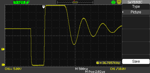

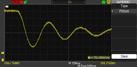

    Than i add 220pF snubber capacitor to its place.
    NO-LOAD (Except 2Ks) + 220pF 100Ohm Snubber
    9.8W + 220pF 100Ohm Snubber
    I think, i don't need snubber at all :) What do you think?
    Harun

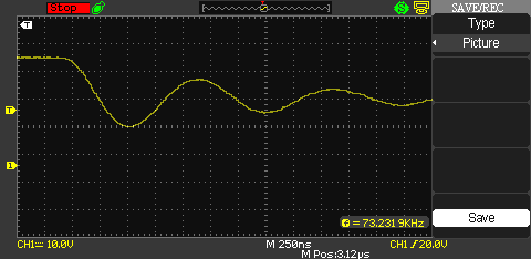

  • Hi Harun,
    First, congratulations that you resolved the excessive Vout issue under no load.
    Regarding the snubber, as shown in your scope pictures, I do not think you really need the RC snubber on the primary side, because the circuit performance is already great.  The RC snubber is used to treat the ringing on the SW rising edge as shown markup below.  It seems your clamp circuit by D1 and D4 already does a great job so there is no need of the RC.
    The lower frequency ringing tail (circled in the picture below)  is the natural resonance between the main inductor and the effective SW capacitance during dead time, in which both the primary FET and the secondary diode do not conduct.  It looks bad but the energy involved is very small: the effective capacitance across SW is less than nF.
    For your info, you may refer to the following two articles by our colleagues if you want to have better  understanding about the snubber and the natural resonance tail.
    https://www.ti.com/lit/pdf/ssztcw6
    https://www.ti.com/lit/pdf/ssztcv6
    Hope this helps.
    Youhao
