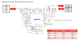

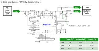

We are fabricating and evaluating a BQ25730 board.

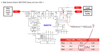

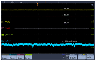

We are evaluating multiple boards, and a problem occurs where *BATDRV does not transition to 'L', so the BATFET turns OFF, causing current to flow from the body diode of the BATFET to the load. There was a board.
The results of observing input power, load power, and battery power are shown below.

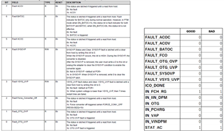

The initial settings of the various registers are the same.
In the above measurements, the PSU and battery were left unchanged, only the board was measured.
I checked the CHRG_INHIBIT on the board that is not charging and it was 0b.
We would like to turn on BATFET for all boards and charge the battery, but do you know why it goes into power pass mode like this?
