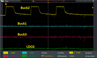

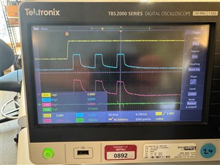

Hi we have a first spin of boards using the TPS65220 PMIC and on a ~20% boards the PMIC does not fully come up.  On the scope we see Buck 2 - 1.8V come up for ~20ms and the discharge and come up for a total of 3x.  See attached picture.
None of the other outputs including GPO2 come up. We also tried disconnecting the Buck supplies from the rest of the board and saw no change.

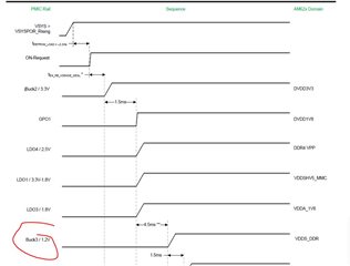

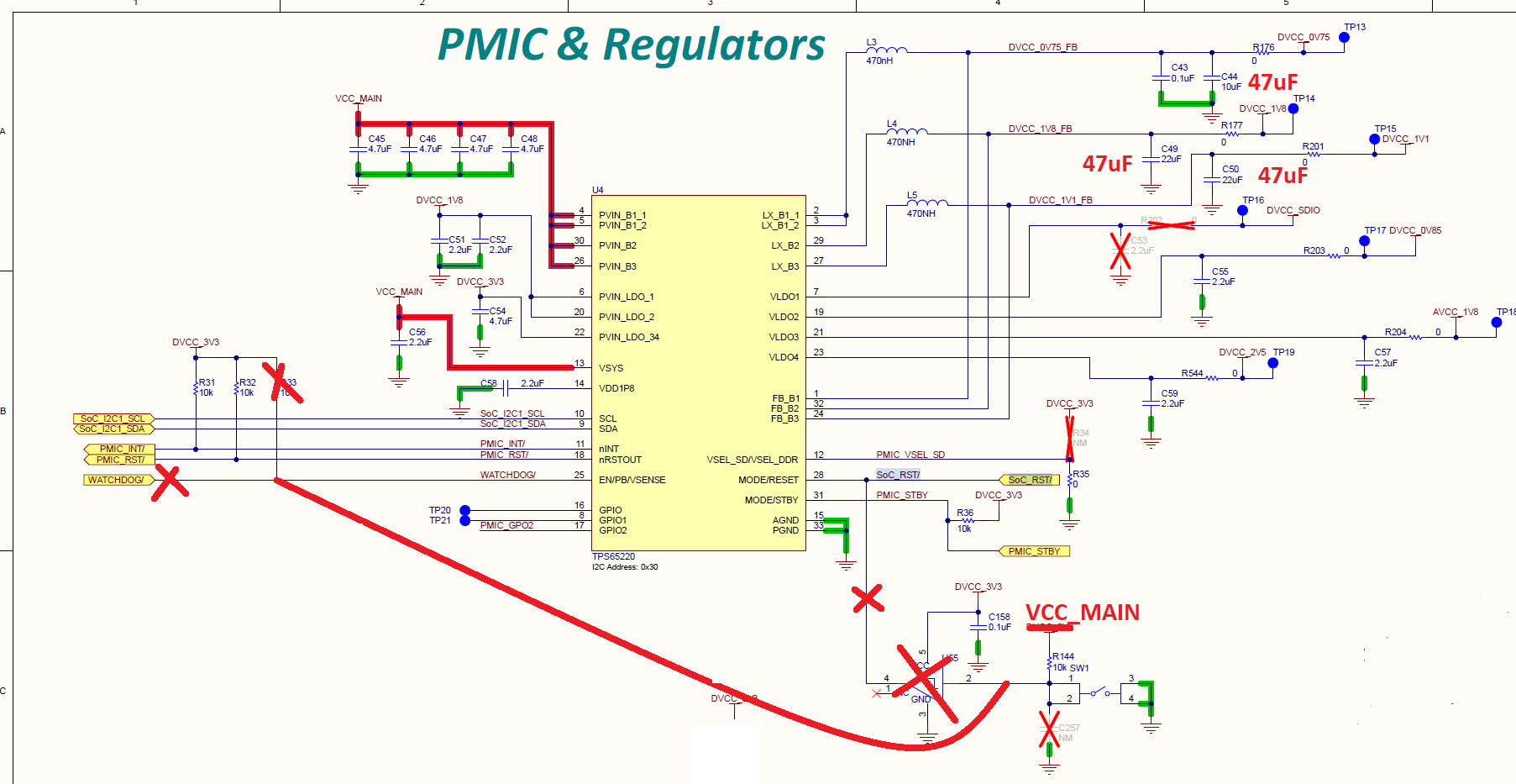

Attached below is a snip of the PMIC page, with redlined rework
Please let me know if you have any ideas!  Thanks
