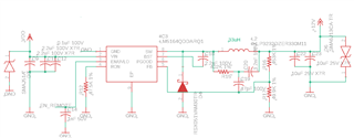

Hi there,
We have a 12V 1A 680 kHz design based on Webench which fails above 48V (we have tested this a few times). Our schematic looks like:
I can share our PCB layout with you but I am fairly confident that it is correct as I have done a similar LM5164 design before but at a lower switching frequency (300kHz).
Below are scopes of the Output Voltage taken at different input voltage of 42V 44V and 46V (left to right) and light load of <0.05A. You can see a large increase in output ripple.
We would appreciate your advice as to what could cause this behaviour. I am concerned that it could be the value of Rr since this value is related to the input voltage.
Thanks in advance,
Steven
