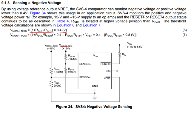

I would like to ask you about the example of section 9.1.3.
I did the calculation and If I am not wrong the equations are exchange.
    VMON(4, POS) = (1+RS41H/RS41L) × 0.4 (V) (6)
     VMON(4, NEG) = (1+RS42L/RS42H) × 0.4 – RS42L/RS42H × VREF = 0.4 – [RS42L/RS42H × 0.8 (V)]
Please confirm if there is a reason behind the datasheet formulation or if there is a small error.
