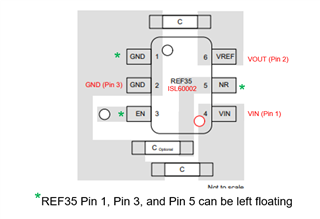

ISL60002DIH311Z-TK
R1243K001A-TR
    1. ISL60002DIH311Z-TK is a 1.2V voltage reference. The best option is REF35120QDBVR (REF35), which can be pin to pin as shown below:

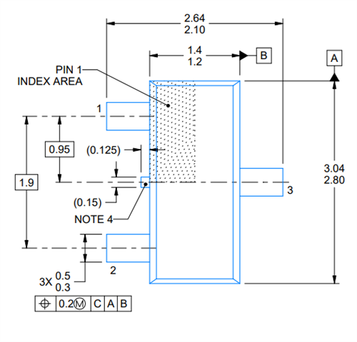

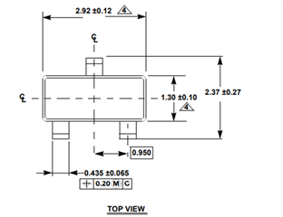

  • Hi Sir,
    For ISL60002DIH311Z-TK v.s. REF35120QDBVR, I found the REF35120 body size is bigger than the competitor's!!!
    Is it really a p2p replacement?
    REF35120:                                                           ISL60002DIH311Z-TK:
  • Hello Peter,
    It will depend on the type of footprint that is on the board. As I showed above, you can create a dual footprint for both devices. If creating a dual footprint is not possible, you could also consider REF3312 (REF3312AIDBZR) which has closer package dimensions:
    However, in terms of specification, REF35 is the superior device to both REF3312 and ISL60002DIH311Z-TK.
    If a dual footprint is acceptable, let me know and I can prepare an example.
