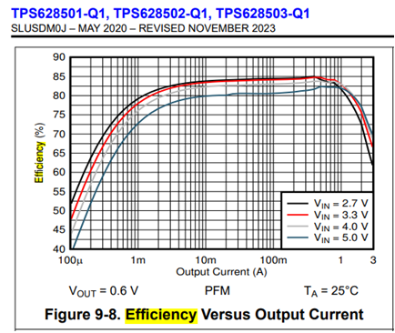

My customer Bosch have a question about TPS628503-Q1 in J6E project.
During the test, they found that the efficiency is a little worse than that indicated in the datasheet. Can you confirm whether it is reasonable? Can you replicate this phenomenon?
Test environment: Vin=3.3V Vout=0.8V Iout=1.6A  FPWM mode Temp=25℃
Efficiency test result: 65%
When Vout is 0.6V in the datasheet, the output current of 1.6A corresponds to an efficiency of about 77%,
Thanks for your support!
