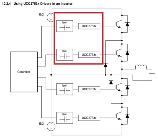

We are looking for the high side circuit. May I know you have reference circuit to share?
BR,
Gary
Hey Gary,
Thank you for reaching out with your questions regarding the UCC27531.
The UCC27531 can be used as a high-side driver and there are a few ways to do that. Please check out the following FAQ on the possible implementations of that.
[FAQ] UCC27624: Can I use a Low Side driver as a High Side driver?
Also, we have half-bridge drivers that can operate as high-side drivers with certain provisions as well. Reference the following FAQ for that implementation.
[FAQ] UCC27311A-Q1: Using a high-side or half-bridge gate driver as a low-side gate driver
Let me know if there are any questions.
