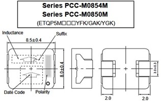

    Can you explain the need of correct inductor orientation? I'm using ETQP5M101YGK, which is a Panasonic metal composite core. On the choke ist marked "polarity". Must polarity go to the IC-side or to the output side?
    Norbert
  • Hi Nobert,
    Polarity marked should be connected to high dv/dt side. That means it should go to IC side.
    Nitya
