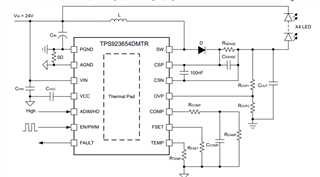

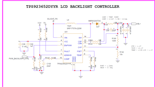

Dear Team,
We have used TPS923652 IC in our design for LCD back light control, Rating for LCD backlight are 270mA max current  and Forward voltage 9.6V.
As per design followed all the steps, even went through forums for technical doubts, even though couldn't achieve required output.

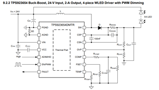

Required output,  To control the  10 to 90% brightness of the TFT display by using PWM signal(Tried PWM dimming and hybrid dimming also). tired both buck-boost and Boost as in our design as we have 24V and also we are steeping down to 5V. so tried 5V supply for boost and 24V for BUCK boost. C95 is 1nF.
Boost circuit works fine, without any issue, but problem with 5V regulator gets heated, so tried buck-boost.
Problem faced:- Output current is not constant when using in CC mode and display flickers.
Please find the attached schematic and changes are made for buck-boost by changing feedback resistor to 680K and 91K(44V(9.6V led forward voltage and 28V max input voltage).
