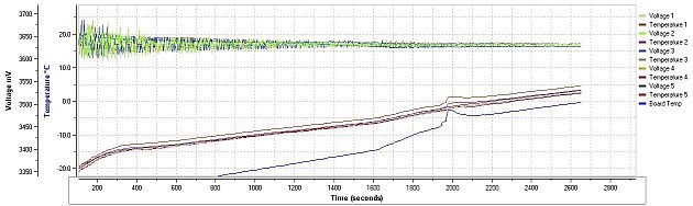

    • The BQ78pl114 balancing does not stop, if low- or high-temperature inhibits normal charge or discharge
    Charge or discharge is not allowed for Li-Ion out of the moderate thermal window. At low temperature of the UN-Test  -40°C (also equal to -40°F) the cells have high impedance and charging or discharging at frozen electrolyte is strictly forbidden. Nevertheless the BQ78pl114 pumps what is equal to charging and discharging. Because of the high impedance, one pump cycle turns the voltage level of the higher cell and lower cell to the opposite. So pumping never ends -> discharge of cells due to pumping, killing cells due to charging/discharging of cells at low temp (also at high temp) -> lowered pack voltage at end of test or fuse -> UN-test failed -> 6000$ crunched.
    Solution -> disable pumping during UN-test -> you have to disable pumping also during shipment -> enable after shipment -> how to do this? Could be challenging! :-))

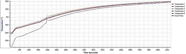

    • The BQ78pl114 has an internal temp.-sensor (board.-temp) which is strongly inaccurate. Beside the calibration point, the error is > 20K at low temp.
    Solution -> ignore all interlan board.-temp readings

    Erroneous pumping and Board-temperature-reading (cell temperatures are ok) at low temperature:
    Erroneous Board-temperature-reading at mid-to-high temperature (cell temperatures are ok):
    Erroneous board-temperature-reading (cell temperatures are ok) at low temperature (-20°C):

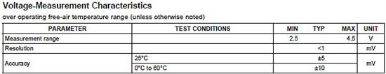

    take a look to the specification, where the recommended operating condition Vsup is (2.3...4.5)V for the cells 1...4.
    Two rows below within the table, the recommended cell voltge difference Vin is (0...4.5)V, this is a little mistake in specification and should be ignored.
    Also the electrical DC-characteristic is specified with Vcell of  (2.3...4.5)V, where all cells are balanced!
    And paremetrize the bq78pl114 to shut down if Vcell < 2.5V.
    And do not forget: voltage measurement is more or less correctly done, if cells are within (2.5...4.5)V and this within (0 ... 60)°C!
    Altogether: this bq78pl114 is not specified to perform correctly out of the consumer range. UN-Tests are definitively out of consumer range!
