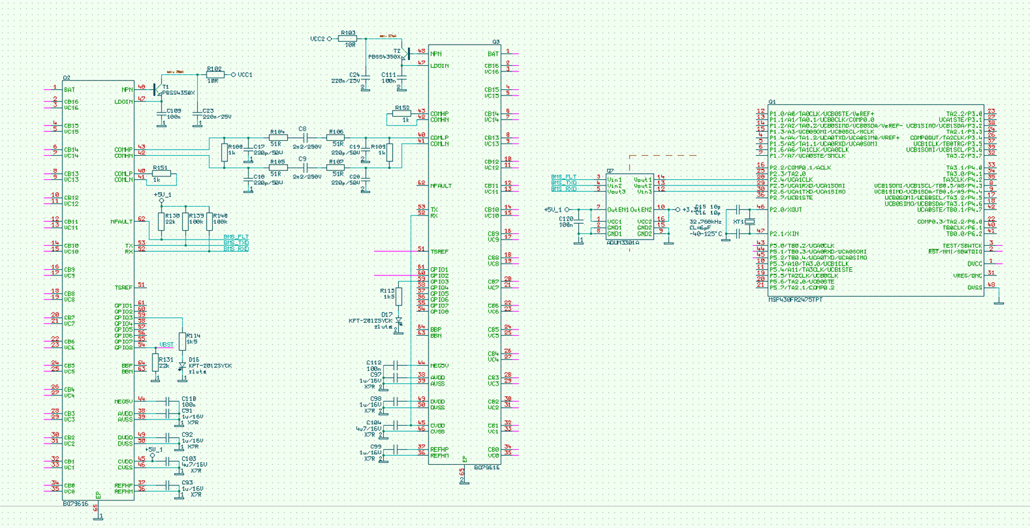

We're going to use your BQ79616 chips. On the board we have MCU MSP430FR... + two BQ79616. It communicates via UART to the first BQ79616, from it goes COMHx signal to COMLx of the second BQ79616 (Daisy Chain Communikations). We measure 30 cells. The UART is decoupled and the COMHx-COMLx is decoupled by a capacitor according to DataSheets.
Communication with the first BQ79616 works (after reset it has address 1).
After the auto-addressing sequence, the first component starts communicating with address 0. If I perform communication with the second BQ796816 chip at address 1, I miss the responses on the UART.
However, I can see on the oscilloscope that the second BQ79616 receives the request and responds with the initial byte count (I tried to read the voltage of the 16 cells and the COMHx-COMLx communication showed a 38 byte response).
But the data was no longer getting to the uart. The response signal has +- 3,8V. The error registers from the master BQ79616 are zero.
The fillet is the query to the second BQ79616, the yellow is the communication on COMH/L between the two BQ79616.
The query and response have different amplitude, but everything is normal.
Do they have to be acknowledged or triggered somehow to receive data, or should they come automatically?

  • Hello Luis,
    Sorry for the delay, but I have more projects. i got around to connecting the second piece of HW and the result is the same.
    here is the schematic:
    Have you tried any command sequence?
    Thank you.
    Láďa

  • Hello Lada,
    The daisy chain circuit looks okay to me.
    My only guess here is that the devices may have not been properly auto addressed. Do you have a log of exactly what sequence is being sent for the auto address sequence here?
    Luis Hernandez Salomon

  • Hello Luis,
    so I am now communicating with my HW.
    The whole problem was that after starting I sent wake-up and addressing + settings. The components responded, but the first BQ did not send anything from the second BQ. Thanks to your SW I found out the following thing. If I do not receive a response from the second BQ79616, I will send Power-Down (D0 03 09 08 CF 72) and start wake-up + initialization again, everything will start working.
    Have a nice day and thank you for your help.
