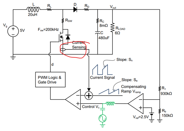

UCC27282: SLVA636 Undefined Variable
Part Number: UCC27282
In application report SLVA636 Practical Feedback Loop Analysis for Current Mode Boost Converter, DC gain of the converter is given by eq(6), Kdc=(D' x Rload)/Ri, but Ri is not defined anywhere in the document.  Does anbody know what "Ri" is?
