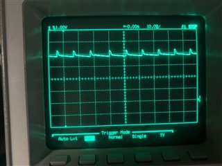

Hi there—we received a customer return with the note that the product cannot charge. I reproduced the issue, and found that our charger (BQ25798) elicits continuous VBAT OVP faults; this is confirmed by the following capture of VPACK:
This is typically a sign that neither the CHG FET nor the PCHG FET are closed, so I connected BQStudio to query the state of the gauge during the failure mode. There was no charging fault (XCHG = 0), and the only safety status (SS) fault was undervoltage (CUV = 1) which is expected:
The register map shows the gauge operates in precharge mode (PCHG = 1), which is expected given the pack voltage was roughly 2.3 V, and our precharge threshold is 2.5 V. When I probed the PCHG pin of the gauge, however, it was only 50–100 mV; this is far too low to enable the PCHG FET:

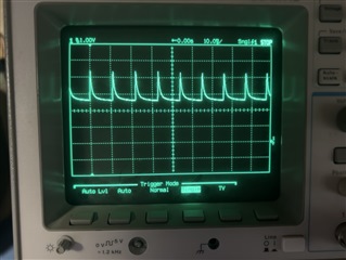

I then sent the FETControl command (0x0022) to disable FW control of the FETs, followed by PrechargeFETToggle (0x001E) to forcibly enable the PCHG FET. The manufacturing status register changed from 0x0018 (FET_EN = GAUGE_EN = 1) to 0x0009 (FET_EN = 0, GAUGE_EN = PCHG_TEST = 1), but the PCHG pin of the gauge remained 50–100 mV as above.
I then sent PrechargeFETToggle (0x001E) once more to forcibly disable the PCHG FET. The manufacturing register changed to 0x0008 (FET_EN = PCHG_TEST = 0, GAUGE_EN = 1), and the PCHG pin of the gauge was pulled up as follows:
My naive assumption is that there is some sort of HW problem here—is there any other explanation for why the gauge cannot drive the gate of the PCHG FET?

  • Hi Anthony—thank you for your prompt support! I've root-caused this issue, but I still need some help to implement a workaround. In response to your questions:
    When this was done, was FET_EN still cleared? Is there any change in the performance if a reset is sent?
    I can confirm that FET_EN remained clear while I sent the PrechargeFETToggle command (0x001E) to manually control the PCHG FET. Prior to this experiment, I sent the FETControl command (0x0022) to enable manual control.
    The behavior does not change if I send the DeviceReset command (0x0041).
    Also, is XDSG still set at this time?
    XDSG is set in both manual mode (FET_EN = 0) and automatic mode (FET_EN = 1); this is expected, as the gauge is in CUV. XCHG is set only in manual mode (FET_EN = 0) while both the CHG and PCHG FETs are disabled (CHG_TEST = PCHG_TEST = 0).
    After investigating this further, however, I realized that the PCHG FET is in fact a PMOS, and the datasheet gate drive voltages are understandably specified as VCC - VPCHG. Therefore, the gate drive voltages I measured in both manual mode (FET_EN = 0) and automatic mode (FET_EN = 1) are expected, and the gauge is operating as designed.
    The question then becomes why the BQ25798 cannot push current into the battery and repeatedly triggers an OVP fault, even though the PCHG FET is conducting.
    On a hunch, I shorted across the precharge current-limiting resistor (R1 in figure 9-1 of the BQ40Z50-R2 datasheet), and the battery can charge normally. I loosely suspect the BQ25798 may act as a weak constant-current source in precharge mode, and cannot overcome R1.
