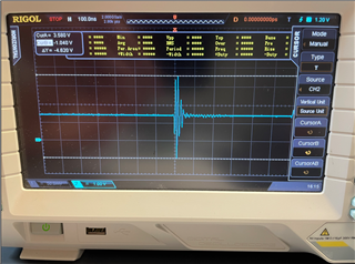

I am working on a flyback design to bring 24V down to 15V with an input range of 14V to 37.5V. The positive output of the secondary side of the transformer (pins 9 and 10 of U2 in the schematic screenshot) has the following behaviour:
The positive ringing seems to be getting choked off early. This results in an output at TP1 that only reached 1.4V (rather than 15V):
The schematic is below:

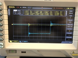

    I changed out the current sense resistor for a 20mOhm one and swapped the compensation components for the ones on the dev kit. This yielded this result:
    The blue being the input and the yellow the output. Thoughts?

  • Hi Youhao,
    I wrote that entirely incorrectly, sorry. The blue trace is the positive output of the secondary side of the transformer, whereas the yellow trace is where we expect 15V (after the snubber, at TP1 on our schematic).

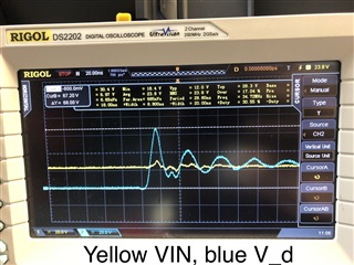

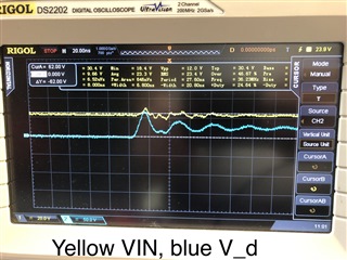

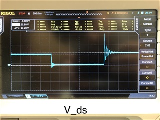

  • If you still have problem, please capture VIN, Vds of the FET, Vcs, and Vcomp on the same scope picture. Please use a probe of short ground lead for Vcs signal.
    Youhao
  • Hi Youhao,
    We are still seeing issues. We do not have enough probes on our scope to measure all of those, so I have measured everything with VIN (a.k.a. FLY_IN+). We have VIN & Vcs, VIN & Vcomp, VIN and Vd (the drain voltage with respect to the ground at TP5), and separately we have Vds.

    Since the issue has been resolved, let me close the thread here.
    For those who are interested in this thread, the main problem is in the current sense resistor.  The original 50mOhm and also the routing of the resistor leads to hit the current limit. 20mohm resistor works for the circuit and the routing should be improved to prevent large parasitic PCB inductance on the Rcs current path.
