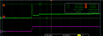

  • hi SIR
    Below chart is show the output of LM1117,
    in the case, the vin is 12v, Vout is 5v, current about 660mA peak
    the LM1117 Is suit for this case?
    thanks

    if any passible, the LM1117 OCP on the PCB? so output drop down to 3.8v or 0v? - Could you please share scope shots and pictures of the test setup for this item? What is your Iout? The 0V case could be related to thermal shutdown but I need to know Iout to confirm that.
    in the case, the vin is 12v, Vout is 5v, current about 660mA peak the LM1117 Is suit for this case? - At this value of Iout, power dissipation in the LDO is 4.62W which would likely cause thermal shutdown. But this depends on package used, board layout and ambient temperature. What is the package you are using?

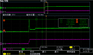

  • hi  sir
    1: remove the ceramic output capacitor, LM1117 Still output 3.8v in some pcb
    2.Green line is current waveform in back of the LM1117
