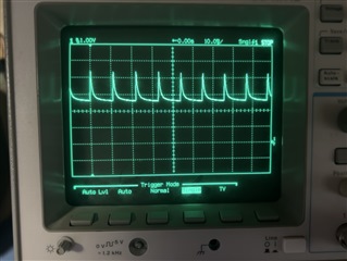

I measured cell voltage (2.2 V DC) on the cell side of the precharge current-limiting resistor, and the rapidly enabled and disabled charger output on the pack side of the precharge current-limiting resistor as follows:
This is synonymous with the battery being disconnected, although it is not—it simply seems as though the charger cannot push current through the PCHG FET of the pack. I shorted across the precharge current-limiting resistor, and the OVP fault was removed. The same registers suggest the BQ25798 is successfully precharging the battery:

    The charger is pushing current through precharge resistor and that is causing the OVP since IPRE = 0.8A*100ohm + VCELL > VREG.  What is the voltage at the BATP pin when this occurs?  But you are correct in that the charge should have taken over precharge when battery drop below 74%*VREG and therefore never dropped to 2.8V.  The most common issue is too much SYS load current for the charger's input power, which requires supplement mode = battery drain.

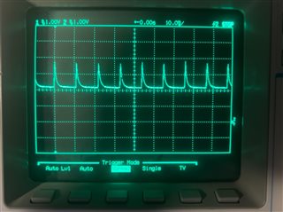

    This waveform is essentially the same as that of the pack side of the precharge current-limiting resistor, with the troughs raised by a diode drop:
    I think we're simply seeing the body diode of the DSG FET in the pack—once the converter briefly shuts off in response to OVP, any pack-side capacitance bleeds off into the battery until the body diode stops conducting.
