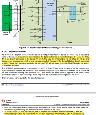

I want to use Bq79758/Bq79718 for my 16S BMS application. I want to use single AFE as base device (Don't want t stacking in this)
  1. As we want to use it for single device application, We can use UART communication only (SPI not possible) if we don't want to use any External IC such as BQ79600/ ISO7342 as mentioned in datasheet?
  2. As per datasheet section 8.2.2

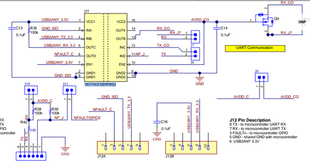

ISO774 is recommended for UART. As we don't want isolation, I want to connect it to MCU directly as mentioned in option 2. Do you have any application circuit for that. It will invert the signal, right? Can we try this with EVB board as well? Is Q4 in EVK board is for same purpose?
