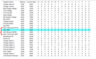

  • As an update, I do have the EVM for the BQ25723. I am running the same scenario with a 4S cell configuration, but I am still not getting any reading for the discharge current, even when using a digital load and observing a discharge of 1A at 15V.
    Thank you for your assistance!
    Charge Option 0	E70E
    Charge Current	0000
    Max Charge Voltage	41A0
    OTG Voltage	09C4
    OTG Current	3C00
    Input Voltage	0000
    Min System Voltage	7B00
    IIN_HOST	4100
    Charger Status	0000
    Prochot Status	B800
    IIN_DPM	4100
    ADC VBUS and PSYS	0000
    ADC IBAT	0000
    ADC IIN and CMPIN	0000
    ADC VSYS and VBAT	0000
    Manufacture ID	E040
    Device ID	00E0
    Charge Option 1	B300
    Charge Option 2	00F7
    Charge Option 3	9434
    Prochot Option 0	4A09
    Prochot Option 1	41A0
    ADC Option	E0FF
    Charge Option 4	0048
    Vmin Active Protection	0004

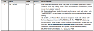

  • Hello Ali,
    However, my current issue is that when there is no power input and I am only using the battery, I am not getting any reading for the discharge current.
    When there is no input, the device is automatically in lower power mod.
    Please refer to the EN_LWPWR bit in the datasheet. ADC is not available in low power mode. Disable low power mode.
    This should resolve the issue.
