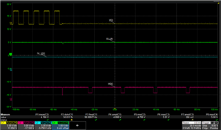

    2) when we connecting external wire (thin copper wire for probing at WDI,WDO,5V supply line) or the tools( such as miniprog, winades,) in DAP connector the signal lines are disturbed and getting random reset- below you can refer the waveform taken at that time,
    Full waveform :
    Zoomed in waveform:
    3) next when we connecting miniprog in DAP connector for flash. During flash some times it is getting reset (randomly 2 out of 5 times) you can see the waveform taken at the time of reset.

  • Hi Praveen,
    Thanks for clarifying the difference and providing more information regarding this inquiry. I looked into your points #2 and #3. Please find my comment in below.
    2) It seems like the negative edge is not in the valid window. ( When CWD = NC, SET0 = 0, SET1 = 1)
    Please find the correct operation in below.
    3) In this waveform, the WFI signal is quicker. I noticed VDD is almost going to Vdd(min) for all the scope pictures. Is there anyway you can test with VDD signal is higher than VDD(min). Just want to make sure VDD is being close to Vmin is not disturbing anything.
    Hope my feedback helps! Let me know if you need further assistance.

  • Hi Praveen,
    You can connect SET 0 and SET 1 either to MCU or directly to VDD/Ground. There shouldn't be any difference for device behavior as long as they have the proper voltage low and high.
    I want to highlight whenever the LIN_SLP_N signal goes low, it seems like the VDD and WDO output is having the issue. I want to check what is the purpose of LIN_SLP_N signal to better assist you. And is it a signal that you can stop toggling for only testing purposes?
    I think the further step for debugging would be:
    Remove the DAP connector and and stop toggling the LIN_SLP_N signal, provide the proper WDI signal as in the second oscilloscope picture, and record the RESET behavior. I think this way we can understand the TPS3430 behavior.
    And could you please let me know is this seen across multiple devices or only for this device?
