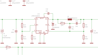

Hi to TI support team,
i did this design, which works well now but with some emc problems.
The emc test engineer recommends, to populate a 2.2nF capacitor parallel to R21 (RT/SYNC) resistor.
He said, this improves emc conducted emission. Are there any concerns about populating this capacitor?
